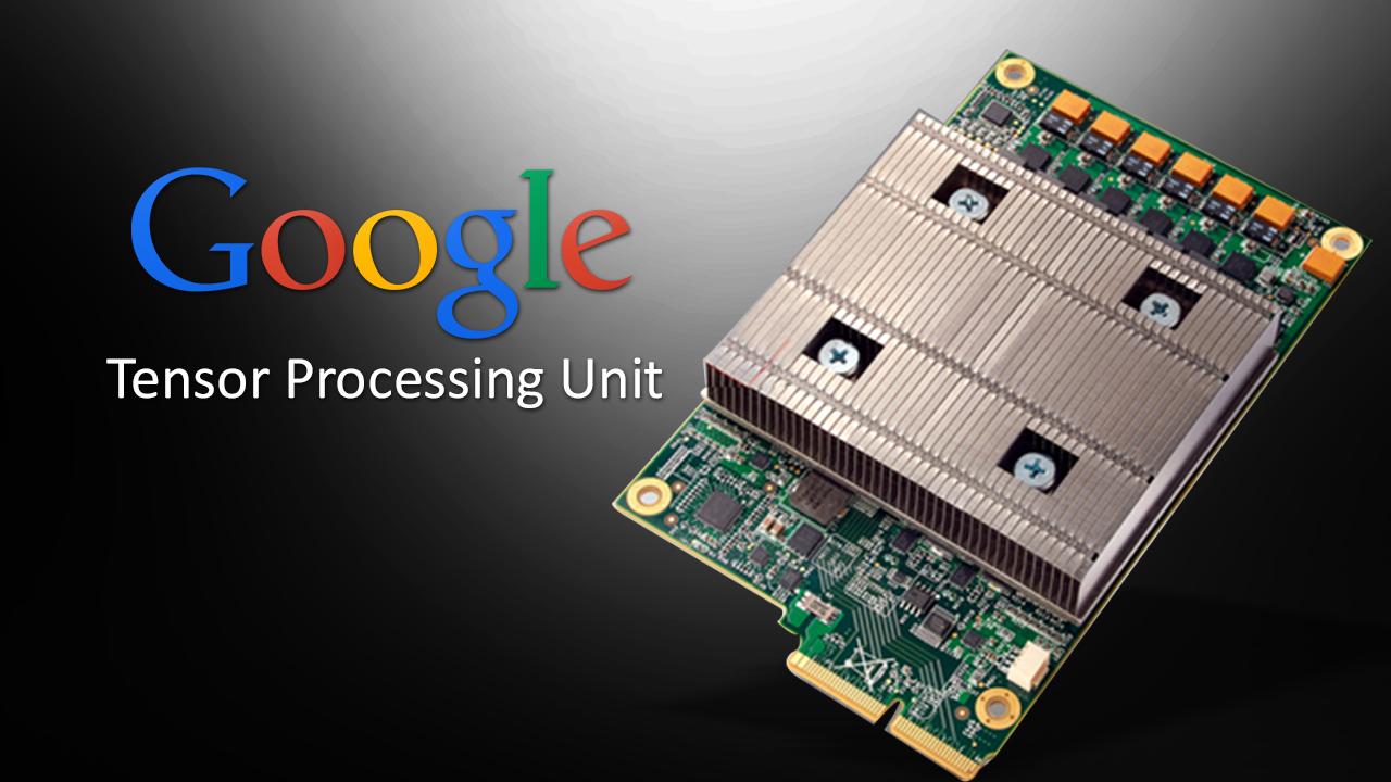

The TPU ASIC is built on a 28nm process, runs at 700MHz and consumes 40W when running. Because we needed to deploy the TPU to Google's existing servers as fast as possible, we chose to package the processor as an external accelerator card that fits into an SATA hard disk slot for drop-in installation. The TPU is connected to its host via a PCIe Gen3 x16 bus that provides 12.5GB/s of effective bandwidth.

well looking at the massive heat sinks, I highly doubt Google TPU2 is still 40W. My guess is around 80W which is very poor efficiency for a dedicated chip of this performance (45TFLOPS)
for comparison, the first TPU rated at 40W looks like that:
Quite possible, I really have no idea what the wattage is. Either way though I think it's a bit misleading to say that 45 TFLOPS at 80W is very poor efficiency, seeing as it would still be comparable to GV100 (120 TFLOPS at 300W), and equal or better than TPU 1.0 (92 INT8 OPS at 40W, assuming that you treat 2 INT8 OPS as equal to 1 FP16 OPS).
No it's very poor when compared to GV100 because the latter at 300W is with rasterizer, geometry engine, texture unit, FP64, FP32, INT32, hardware scheduler when TPU2 only does FP16 matrix. In other words, GV100 will be far from 300W if it had only tensor cores...
So what if it includes all of those things, they won't be active when running tensor type workload, and thus won't contribute to the power usage (except for the hardware scheduler which would possibly still be active with tensor workloads), and you have no idea how much power GV100 will be using when only running tensor operations (unless I missed some announcement from Nvidia on this).
