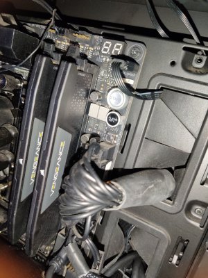

The fact that, "Armory Crate detects this as an Addressable Header" suggest strongly that you have plugged the cable from the case lighting hub into the wrong mobo header. That mobo has BOTH types of lighting headers. It has THREE of the 3-pin Addressable Gen2 headers (see manual p. 1-17) of which ONE is at top front. And right next to that one is a FOUR-pin AURA Sync RGB header (p. 1-19). That 4-pin one is the one you must use for this lighting type. FURTHER, note that the header labels show the pin on one end marked as the +12 VDC power line. The female connector from the hub cable will have the hole on ONE end marked. THAT MUST be plugged into the pin for 12 VDC. So check that the plug is turned the right way.
Lastly, note your case manual on p. 19 at the bottom on how to use the case's three RGB Controller buttons at top front. To get the mobo to take control of case lights you must push the M/B button. You may need to do this every time you boot up - the manual is not clear on whether or not this setting is saved.

Yep I connected to the Aura RGB header, and the 12v pin is rightly aligned with the motherboard 12v pin. Here's a picture.

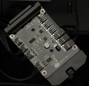

One other thing you could try is that it looks like the controller has multiple outputs. Have you tried a different output to see if the RGB strips do anything different?

Haven't tried it yet, the controller only has 3 output headers. Heres' the pic

Just now I tried swapping out the headers one at a time, didn't work like it should be. I am guessing the controller is not interpreting the data correctly. I am going to try connecting a brand new led strip to the controller and see if this happens. If not its the case RGB strip, else its definitely the controller
So I tried switching the RGB connector on the controller from RGB 1 to 2 and 3, still the same.
What do you think might be causing the controller to not interpret the data correctly?
That's just my thoughts. It appears to me that the "controller" doesn't do much other than switch from "motherboard control" to "case control" and also provide the colors under "case control". It should just pass on the information if in "motherboard control". But I don't know that is how it works for certain. It may do other things.
Did you have an RGB strip that can be plugged directly into the motherboard and test if that one works correctly? That would certainly narrow down the issue.
The other form of testing would be this. Unplug ONE of the lights attached to the case board. Unplug the cable from that board to the mobo 4-pin plain RGB header and plug JUST that one light strip into the mobo header. Now see what that one strip can display. If it displays things correctly, then you are sure the WRONG displays are being generated by the BOARD. BUT if the single strip displays the same wrong colours, just like when it is part of the board's output group, then the MOBO header is sending out wrong signals.The result certainly should satisfy the Tech Support people of whichever faulty unit (board or mobo) is to blame.
