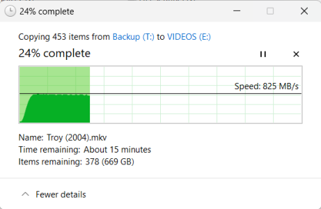

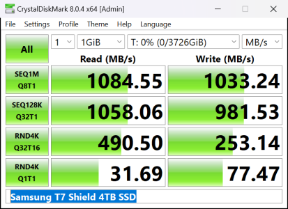

I bought the Crucial X10 Pro directly from Crucial's website a couple of months back.
First problem is my laptop took 1 min. longer to boot, something was up with that drive that caused it to cause POST delay. Then the drive just failed after I copied all my data to it within a few days. Crucial then asked me to send it back for a refund which I did but ended up losing some money on shipping costs though. I then bought a Samsung T7 4TB external SSD and this thing is super fast and reliable as was my 4 year old Samsung T5.
Samsung T7 Shield 4TB Real-world write speed.pngSamsung T7 Shield 4TB SSD CrystalDiskMark.png
