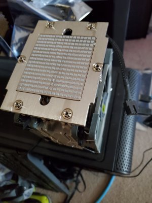

Building a NAS server (mostly data storage, no major computational load envisioned) around the EPYC 9124 (SP5, 200W TDP). To be used in a regular uATX case, i.e. no rackmount, no huge jet-turbine-like datacenter fans involved. Should I attempt a passive solution, or should I go with an active heatsink?
(Does Noctua make CPU coolers for the SP5 socket? I couldn't find any!)

Edit: Thermal paste: all 3 use this methods, and it works. But I had to redo the pase on one, as I had to change CPUs. mine are on 9554's. If you get it, make sure you torque it in order as the spec from the motherboard using the threadripper tool ot to 13.3 inch pounds.
Yeah, I've been told it might be loud. I will cancel it, and order the one you recommended, thanks.
BTW, on my 9554's with all 128 threads loaded it is fairly quiet and runs as high as 87C, but it can go to 100c. Also, it does 3.5 ghz on all 128 threads ! On a 16 core, damn it should be fast !

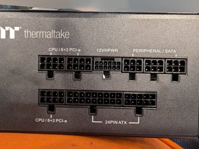

@Markfw: Alright, I got everything I need, finally, and just assembled them all together ... only the mobo doesn't power up!!! Not sure I made the right power connections though: mobo has 3x8 pin + 1x4 pin power inputs. I only connected one of the three 8 pin inputs: should I connect them all? The 4 pin is being powered via 18-to-24-to-4 pins cables.
Here's what the PSU looks like:
What mobo is this again ? You need ALL of the 8 pin cpus populated, but I have never seen a motherboard that takes more than 2. and a 4 pin also ????
OK, then plug in ALL the 8 pin and the 4 pin. Clearly they are all power.
"1 (4-pin, ATX PSU signal) w/ ATX 24-pin adapter cable, 3 (8-pin, ATX 12V) support 12V DC-in"
Edit: actually, you don't have a 4 pin power in addition to the 3 8 pin.
Now motherboard ??? Take that one back ??? my
Supermicro Server Motherboard MBD-H13SSL-N Socket SP5​
Only requires 2 8 pin. + 24 power.
If its easier to return the PSU (first see if you can find one with 3 8-pin CPU + one 4 pin) then take the PSU back. one of them has to go.
EDIT: I just thought of this. Call ASRock tech support and tell then you only have 3 6+2 CPU plugs, and ask them what to do.
I just bought another 8-pin cable: it should arrive tomorrow morning. In the meantime let me see if the mobo powers up with only 2 of the 8-pins populated.
