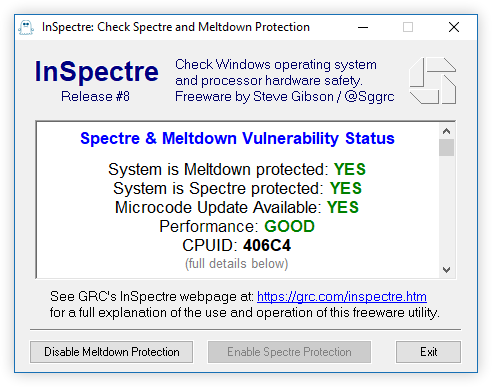

https://www.grc.com/inspectre.htm
Here is a really good program to see if you are vulnerable to Spectre or Meltdown. It also has the ability to turn off the fixes if you are having severe slowdowns. Also if you click on the ghost in the upper left corner you can get more tech information about your system. When you run the program, read the text and see what's green or red to find out the vulnerabilities of your system.
I tried it out. I'm a little sceptical of its "performance analysis" which appears to be nothing more than "if patch is installed then performance = slower".
It would be nice if One runs a fast Benchmark of each state instead of just complaining.
I checked my notebook with all patches installed and it didn't show a slower performance.
