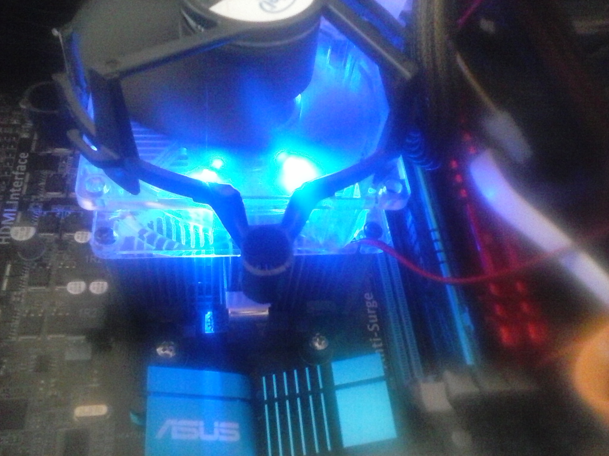

First consider a more aggressive fan profile. If it doesn't suffice or if fan noise bothers you another good and very cheap way to improve thermals is to epoxy a clockwise spinning fan on top of a weak stock cooler. This is my setup:
If that doesn't help enough and if you at all have any doubts about the thermal paste quality or install job, consider reinstalling it with decent paste. just take great care when removing the heatsink (otherwise you might pull the whole cpu off and risk the pins); pulling it from your old phenom should have been good practice.
