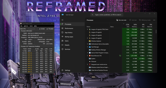

Under load, all cores reach 95–100°C with thermal throttling active. Radiator fans are running at full speed but temperatures don't drop.
At low power draw (15–25W), temps stay around 45–50°C. As power demand increases, temperatures rise disproportionately — hitting 100°C even at 60–70W. Calculated thermal resistance is ~2.68°C/W, whereas the expected value for a 360mm AIO is around 0.30–0.40°C/W.

I noticed the pump header was set to DC mode in BIOS — switching it to PWM dropped the CPU from 99°C to 56°C. I then found the pump cable was connected to the wrong header and fixed that too. I set power limits to Intel stock values, enabled C1E, reapplied thermal paste multiple times using Arctic MX series, ran an air bubble test by tilting the case in different directions, and went through every relevant BIOS setting I could find.
Each step helped a little, but the problem never fully resolved.
Current Readings

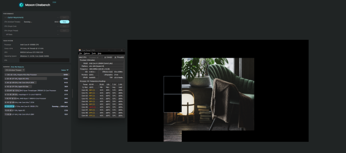

Idle (12–15W): 45–50°C — expected 35–42°C

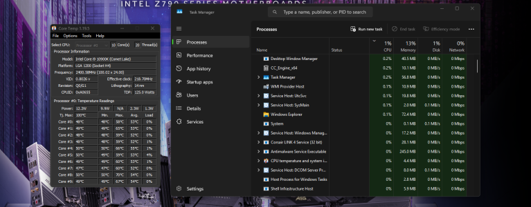

Cinebench R23 (85.9W): 97–100°C, 100% load — expected 65–80°C
Cinebench R23 score: ~2,860 pts (due to throttling) — expected ~7,500 pts
Gaming, 25% CPU load (65W): 93–99°C — expected 55–70°C

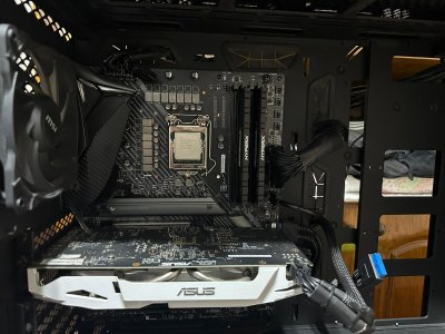

That's really useful to hear from someone who's worked on the same generation. The PA120 SE is already on my list but I'm a bit worried about fitment — attaching a photo of my current setup. The RAM sits pretty close to the socket and the VRM heatsinks on this Z490 board are quite large. Do you think a dual tower like the PA120 SE would clear everything, or should I be looking at something more compact?PC CASE.jpeg

Agreed, time for a new cooler. Preferably air rather than liquid — complexity and longevity are both concerns after this experience. Case limit is 170mm CPU cooler height, socket is LGA1200, and the board has fairly large VRM heatsinks with high-profile RAM sitting close to the socket. Any long-lasting air cooler recommendations that would fit and handle a 10900K?
@daveybrat
That's really useful to hear from someone who's worked on the same generation. The PA120 SE is already on my list but I'm a bit worried about fitment — attaching a photo of my current setup. The RAM sits pretty close to the socket and the VRM heatsinks on this Z490 board are quite large. Do you think a dual tower like the PA120 SE would clear everything, or should I be looking at something more compact?View attachment 139832
Sure, go with the Thermalright Royal Knight cooler instead. It's designed to allow for the ram and VRM clearance you'll need on that setup and is still a beast of a cooler.
