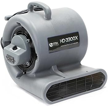

Challenge accepted. I think this would create "too much positive pressure" for that case 😉
3,300 CFM
Seriously, I looked at the detailed pictures of that case after aigmorla responded, and that is one very open case.
