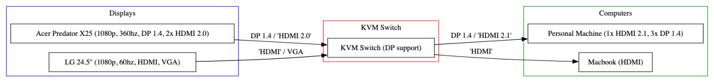

You'll have to look for an "active" HDMI output to Displayport display converter for your macbook, and pray that the whole contraption works together properly.
I appreciate you taking the time to explain this. Just to make sure I follow, is this what you're suggesting?
yeah, that's what I'm suggesting
Edit: My bad, I was assuming it was a 2x2 matrix switch. If this is a more traditional uni-display KVM, then no, what you want isn't possible.
Sorry.
How old is this Macbook? Does it only have 1x HDMI? Can it output via another method as well?

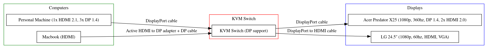

Alright, I got a HDMI->DP adapter and a DP->HDMI cable and hooked everything up like in the diagram.
Bizarrely (to me), everything works except that the secondary monitor is not detected by either machine. Switching between machines works fine, the primary display works fine, but the secondary display doesn't get any signal and doesn't show up in display options / xrandr. What might I be doing wrong there? Is it possible I somehow got the "wrong" DP->HDMI cable? https://www.amazon.com/dp/B07ZQ7K6S1
For KVMs I really try to stick with native connections as much as I can as introducing adapters just adds variables to the mix to cause problems. At home I have 2 KVMs, They are TESmart HDMI. So I made sure that my entire cabling is HDMI for both PCs. Finding a GPU with 2 HDMI ports was weirdly hard though... seems everything is DP now. Suppose if I was to do it over I would get the DP version of the KVM and do DP for everything. DP has a much shorter max cable length though... I think that's why I ended up going HDMI. My8 PCs are in the server room and I have 25 foot cables coming to the office.
For my work machine though, everything is DP, so I use DP to HDMI adapters going to the KVMs. That took a bit of trial and error to get going, some adapters would just refuse to work, or flicker, or do weird crap. Also need to watch out, as some adapters don't support 4k.
But yes be aware of the signal direction when using adapters as most of them are active, as in, they have actual circuitry inside that does conversion, so they are directional.
Oh, and for me I actually had to set both refresh rates to 50hz, for some reason 60hz causes the 2nd monitor to flicker. If I use different rates, when I drag a window across both monitors it looks really weird. So I try to stick to same rate across the board.
