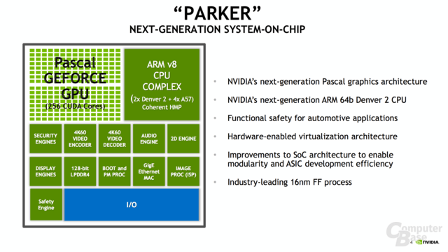

NVIDIA Tegra Parker Unveiled
- 2x Denver2 cores + 4x Cortex-A57
- Significant perf/watt improvements
- Highest performance ARM CPU
- 256 Pascal-based CUDA cores
- 50 GB/s bandwidth (twice Tegra X1's 25 GB/s)
- TSCM 16FF

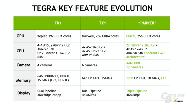

Better memory compression, too. Should be very helpful when we're talking about an SoC with only 50GB/sec bandwidth for six CPUs, GPU, and a bunch of other clients sitting there with non-trivial bandwidth needs.
Ah, I was just thinking about the actual shader cores, not the memory subsystem. Yes, the improved compression would be a great help- though I wouldn't be so sure that Tegra X1 didn't have a similar system in place already. It's a 20nm "Maxwell" GPU which is slightly different from desktop 28nm "Maxwell", having stuff like FP16 SIMD instructions.

You really think that thing is going to fit into a handheld, with 6 "big" cores and a 128-bit memory bus? 0_o I would expect a semicustom chip which stripped out a ton of the automotive stuff and had a small CPU cluster.
It generally has a higher clock, so yes.
I do, clocks/power consumption can be tweaked to the proper level and the rumored Nintendo part has to do double duty as a home console connected to a TV.
If the full 4 A57 + 2 Denver 2 configuration makes it to the NX, I'd definitely give the CPU side of that a slight nod over 6.something Jaguar cores.
It's a tablet form factor, and phones already absorb similar core layouts.
The PS Vita had 128 bit memory years ago in a smaller form factor than the NX.
What makes you doubt that's possible? Tiny phones have 4 A72s. And it's also likely it'll clock lower when mobile than when docked.

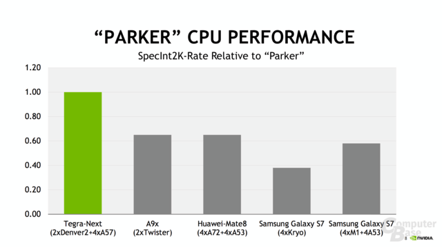

The most impressive CPU in NVIDIA's CPU performance chart is the Apple A9X/Twister by far. It is a dual core matching 8 core A72+A53 parts. Qualcomm's Kryo gets utterly wrecked.
But to be fair, it's a tablet (with tablet-oriented SoC) being compared with phones that have lower thermal headroom. A9 might be a better comparison.
Looks like there's something about Qualcomm cores doing especially badly on SpecInt2k. nVidia loves beating them up over this, I remember when they gloated about Cortex-A9 having higher IPC than Krait in this.
When you get down to it, it's really telling that this is the one and only bench nVidia shows.. a very (unrealistically) parallel benchmark that they can win with brute force having enough "big" cores, most likely with no thermal constraints whatsoever. Contrast with the publication of the first Denver in K1, where they listed several benchmarks.

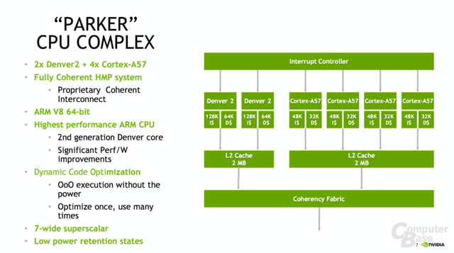

I wouldn't doubt that it would totally power off one of the clusters (probably the a57's?) and heavily downclock in mobile mode, relying on the wide low-clock Denver cores. You can aggregate many threads to fewer cores, just not the other way around. So developers would target a full 6 core workload while writing the code and it would get aggregated in mobile mode onto those Denver cores which are especially wide and especially good at getting ILP out.
Since Denver needs software to optimize the workload and extract maximum parallelism from a workload, I would imagine that they're implementing a cache of some sort for these compiled/extracted workloads to further reduce power
