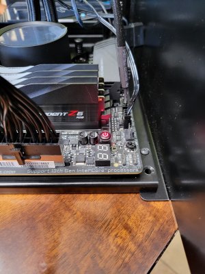

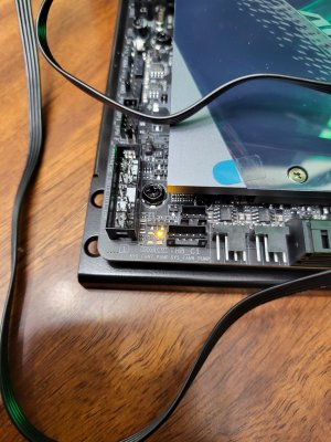

I have just finally put my PC together for the first time and am having an issue I can't seem to find a solution for. I am trying to test operability without my gpu installed, while having every other component installed and connected, when I power on my psu, the lights and fans inside the PC and on the motherboard light up and spin for roughly half a second. I hear the psu click on and off but then it does it all over again and again.
The most notable light that turns on is the cpu led which is amber solid amber for that half second.
I have already done the psu jump test and verified that the psu is working properly
I have also tried to do intensive searching of exactly what a solid amber cpu light on this motherboard means but to no avail.
I would like to add that this is my first time building a PC, I am very familiar with the process (i think) and the basics but this issue illudes me.
