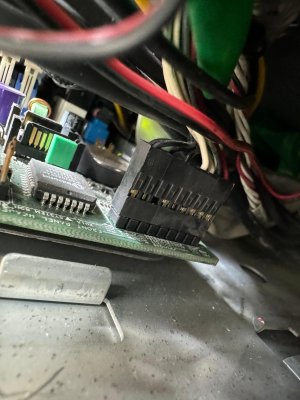

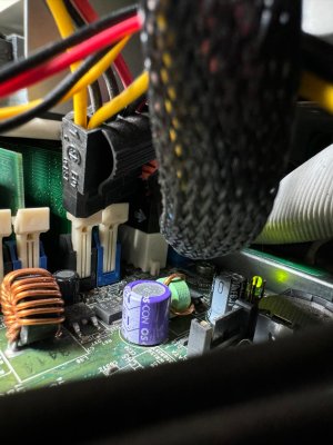

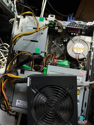

setup: old HP d530 SFF(DK907A) Pentium4, running Fedora 8, power supply 500W HPQ-500BR-H12S, HP P6B580 motherboard (I will attach some photos as well)

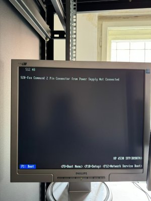

problem: I have to press F1 to boot after PC restart, and I need to make it independent from human interaction, because I am not always near that PC. The message is "920-Fan Command 2 Pin Connector from Power Supply Not Connected"
Any ideas on what I could do so that I don't always have to press F1? thank you so much!!

I assume you're not using the original PSU, based on the photos?
There could be a sensing cable for the original PSU fan that you're missing and it is now throwing up an error, as if a fan failed.
