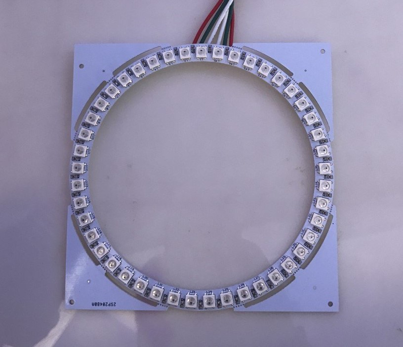

I purchased a set of 5x Aigo Aurora fans of aliexpress for only $50 with a controller, so I was willing to tinker with them. Basically, I took the 6pin connection from each fan, split it into two parts, (1)Fan motor control and (2) addressable LED control (which is just 3 pins, 5V, Data and ground), slapped some new 3 pin JST connectors on each and bang, I'm able to control the addressable LEDs in the Aigo fans with ANYTHING that can control typical 5V, 3 pin addressable RGB LEDs, whether thats an addressable header on a motherboard, or one of the many controllers available, or even something like a rasberry pi, or an arduino. Since the aigo fans use standard addressable IC's, WS2182B I think but don't quote me on that, motherboard lighting control software such as Asus Aura or Gigabyte fusion recognizes them as just any other standard addressable led strip. The one downside is that obviously they'll no longer be working with the included controller since it only has the 6pin proprietary connections orginally on the fans. This does require disassembling each fan, using a volt/amperage meter, and I wouldn't recommend doing it without a reliable, guaranteed and clean 5V DC power source that you can easily connect and disconnect and that you're confident will not throw spikes into the LEDs, and it's also important to be comfortable with a soldering iron, heat shrink, and burnt fingertips. But, since that's not the best and by far not the easiest solution, I'm currently prototyping an addressable RGB LED fan cover like phantek's Halo series, but actually making a good product. The Phantek's Halo is very disappointing as it DOESN'T have addressable RGB LEDs, and doesn't have as many as I would like, so my version is fully addressable, and it contains 45 LEDs instead of the 8-12 in theirs, also you'll be able to daisy chain them meaning they'll only require a single addressable header on a motherboard, or in a controller to connect 3 fans (perhaps more). Now. I'm just working on the best way of diffusion to eliminate hotspots and such. I've included a picture below
hoypVn
. The finished product will have a milled aluminum or maybe stainless mounting plate, and I'm still determining on whether to add a front fascia to direct the light off of the fan blade like phanteks did, or whether I'm going to use a translucent plastic to give it that diffused ring aesthetic
***BTW, not to be mean or unhelpful, but I'm way, way too busy to be able to talk a complete stranger through this process, but I'm sure anyone with a reasonable level of intelligence can figure it out with a little google research just like I did.
hoypVn

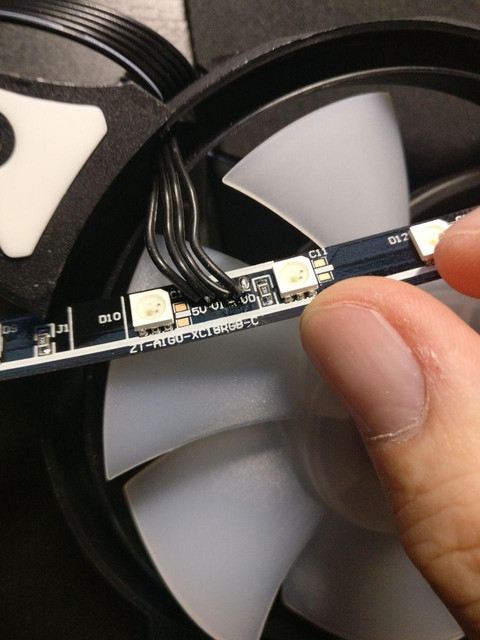

There are actually 4 PIN RBG LED and 2 PIN FAN (+ and -)
Bellow is photo of RGB pins, as i understood it is 5V Din GND Dout, but I'm not sure, I'm going to make controller using Arduino NANO
I HAVEN'T TRIED THIS YET SO TRY IT ON YOUR OWN RISK!!
Hi,
I believe that RGB 4 pins works like following: 5V,Din,GND will be input from a controller like ESP8266 and then from one fan to other fan it will be linked like 5V,Dout,GND -> 5V,Din,GND (This is already done by Aigo fan controller). This way all fans are connected in series and can be controlled one by one. For Fan1 If you disconnect Din from PCB and connect it to ESP8266 data pin (let's say D4). Then connect 5V & GND pin to ESP8266 to power it up. This way you will be able to control RGB strip with least amount of modification. FYI you can use something like "WLED" to control LEDs.
I will post an update after I try it.
