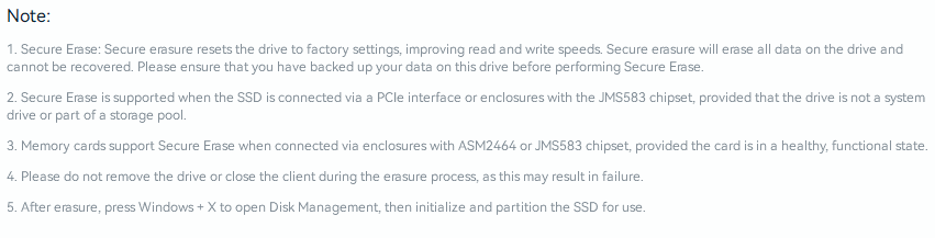

I thought I had a SSD failing on me, one of those HP branded S650 Biwin models that I guess were not supposed to be sold in North America or something, HP NA disclaims any responsibility for supporting them even though they were in totally legit sealed HP retail boxed packaging with a little authenticity hologram sticker. While previously working great, yesterday I tried to use it to transfer over 40GB files at creeping speed, single digit MB/s through external USB 3.1 controller enclosure. Drive has fewer than 20 power on hours.
I check it with HDD Sentinel and BiWin's own utility via external USB controller both said drive health 100% after short SMART self-tests. Like literally as I'm using HDD Sentinel it seem to die on me, the drive became unaccessible, Windows 11 explorer reported no file system error. So I take it out of the external enclosure and plug it directly to mobo SATA controller. It appears to work again so I used BiWin's utility to Quick Erase the drive. I tried to Secure Erase but the option is greyed out and the info area says secure erase is only supported under these weird restrictions:
- Secure Erase is supported when the SSD is connected via a PCIe interface or enclosures with the JMS583 chipset, provided that the drive is not a system drive or part of a storage pool
Dafuq? Suffice to say I don't have PCIe to SATA controller adapter card and no JMS583 chipset, however one tracks one of those down. Anyway I did standard/quick erase provided by Biwin utility. Partitioned drive and formatted. Everything seems fine now. Read/write speeds are restored to normal.
