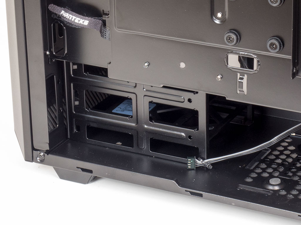

I'm considering getting a Phanteks Eclipse P300A (http://www.phanteks.com/Eclipse-P300A.html) for my next build.
One thing I'm concerned about - I do intend to populate the 2 bottom trays with 3.5" HDDs. However, it seems there is no fan sending air in their direction, leading to above-optimal HDD temperatures.
I imagine that if they put the HDD slots there it's because they figured they'd be doing fine, but it still doesn't add up for me. Is this something to worry about, or will the HDDs be sufficiently cool even without direct airflow? What should I do to mitigate the problem?
Thanks.
There are opening on the side where the drive bay is located.
That heat will be pulled out of there by the case fan(s). They will be in a lot better shape than they are in the closed off small cases of most external hard drives.

I beg to differ. Best practices for a 7200RPM HDD (or even a 10K RPM one, or SAS/SCSI), is active cooling (fan pointed at drive). This is practically a REQUIREMENT if you're going to have drives stacked on top of each other, in successive vertically-stacked drive bays. Trust me, I used to do this a lot back in the day. My drive temps for stacked 7200RPM HDDs, were 35-42C, depending on load.
Just because the big OEMs did marginal things, doesn't mean that you should.
Case airflow may be enough for a single HDD, and most of the big OEMs use 5400RPM HDDs anyways.

Maybe not much difference in temp in your environments, running single drives, but I assure you, running drive arrays, there's a marked difference between power usage / heat output between 7200RPM and 5400RPM drives, especially inside enclosures.
You don't want to run a 7200RPM HDD inside an enclosure without a fan.

Also note that just because an OEM doesn't have a fan directly pointed at the HDD, doesn't mean that they have "0 airflow" over the HDD. Chances are, the chassis design is "thermally optimized", with ducting, vents, and whatnot, along with the chassis exhaust fan, so that there is at least a little bit of air movement over the HDD. Which can make all of the difference.
It's entirely possible, that my gained knowledge about HDDs from running them extensively, both singly, and in groups/arrays in the 90s and 2000s, is outdated with modern HDD technology, and the mfg's have somehow miraculously reduced the power consumption of 7200RPM HDDs as compared to their 5400/5900RPM brethren, but ... I have my doubts, based on experience.

What are your thoughts on the specific situation of the P300A? Do you agree with UsandThem's assessment that it's fine?
