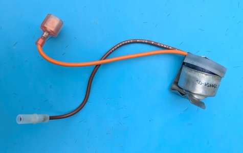

Bought my fridge in 2000. I've repaired it 2 times, 2021 and again the last 2 weeks. Both times the repair amounted to replacing a thermostat.
2021: The freezer temperature thermostat (I guessed right). The freezer had stopped being able to maintain the temperature range
2025: The defrost thermostat had become at best inconsistent and around 2 weeks ago stopped allowing the defrost heater to turn on.
Here's a photo of the bad defrost thermostat I replaced yesterday, note the bulging top, a tipoff that it was the culprit:

Really common issue. Mine was bought in 2002, and the defrost thermostat failed in 2020, just like yours. Fixed for $11.
Hard to believe some just buy a new fridge.

I couldn't find one for $11. I had to pay $21.
