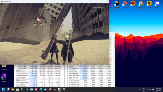

Again as usual you're wrong. This is what happens when you play a game on the Iris Xe iGPU in my 11370H:
The iGPU clearly consumes less power than the CPU cores. This is on Intel. I have no reason to believe that it's any different on AMD.

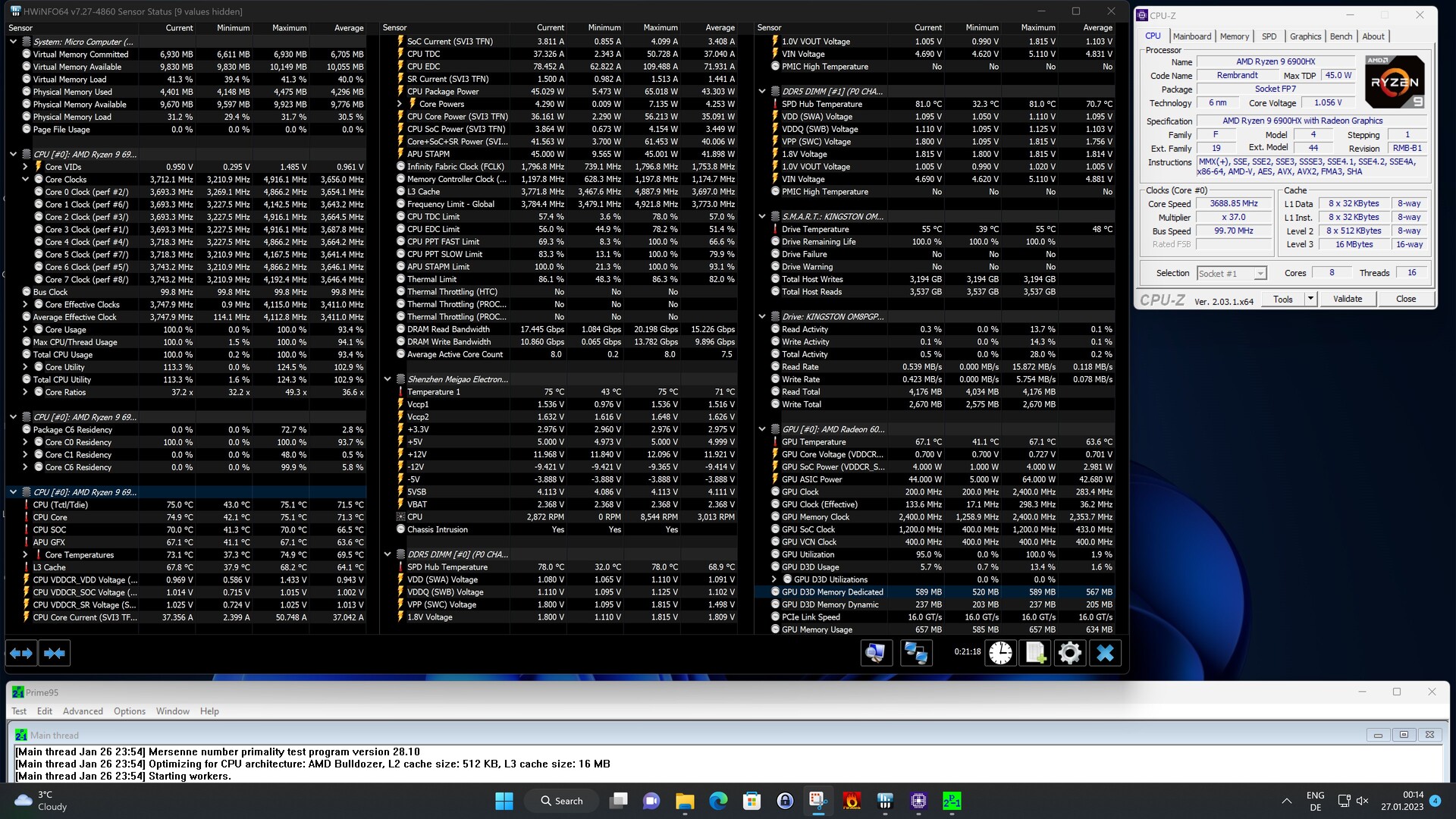

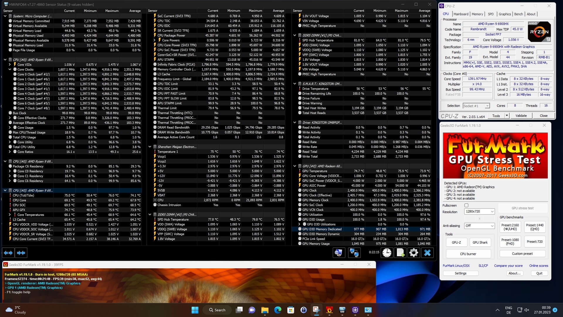

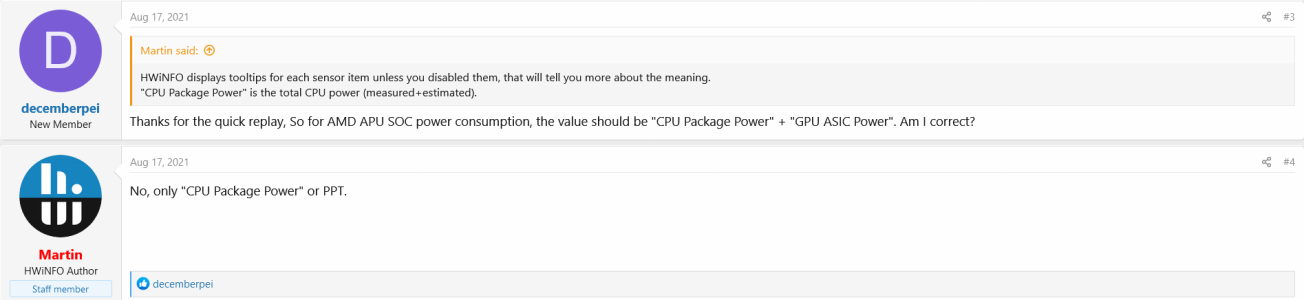

HWiNFO for some reason does not accurately report the GPU power consumption in AMD APUs. Proof?
Here:
This is running Prime95. As you can clearly see, package power is 45 W(as expected, because long duration power limit is 45 W). CPU Core Power = 36.2 W. CPU SoC Power = 3.9 W. Obviously CPU Core + SoC Power = 40.1 W, which is NOT GPU power, because this is Prime95.
Now a GPU Load. Furmark:
CPU Package Power = 45.4 W, CPU Core Power = 35.8 W, CPU SoC Power = 4.7 W. CPU Core + SoC Power = 40.5 W
So regardless of a full CPU or a full GPU load, CPU Core Power remains similar, as far as reporting is concerned, and none of the other reported values show the ACTUAL GPU power consumption. Before you ask, what about GPU ASIC power, here's the author of HWiNFO clarifying what it is for APUs:
So, yeah - till now, neither you, nor anybody else, has actually given any evidence for me to believe that running a 3D load like a game on your AMD APU in laptops means that the GPU part of the APU consumes more power than the CPU part.

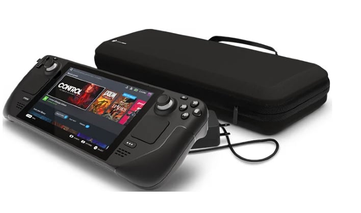

Both AMD and Valve engineers have stated the CPU always takes priority over the GPU on regular chips. Now that does not mean the GPU can’t use more power, that means that if the CPU needs more power, the GPU is going to throttle back.
As I said, the gaming oriented CPUs like the Z1 are different.
Load it consume 56/63W, that show how Impressive Steam deck/Aerith is.
That actually depends on the power mode used. Quiet is most comparable to Steam Deck, though Ally has a bigger screen and the review cops out by stating "The Quiet power mode is not suited for gaming since the performance is just too low." 🤷
Can you post a quote/source for that detail? Don't think we've ever heard the specifics of the "tuning" AMD does.
"Yazan noted on stream that the Deck's power management is tuned to emphasize GPU clock over almost anything else. According to Yazan, the system will throttle charging, downloads, and even SSD I/O to maintain GPU clock rates if necessary."
Quote is from somewhere in this live stream:
