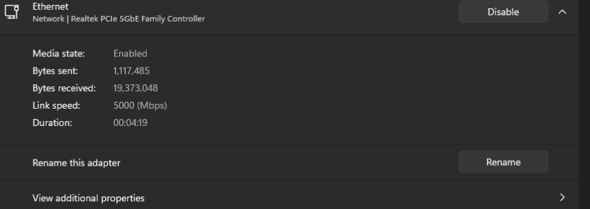

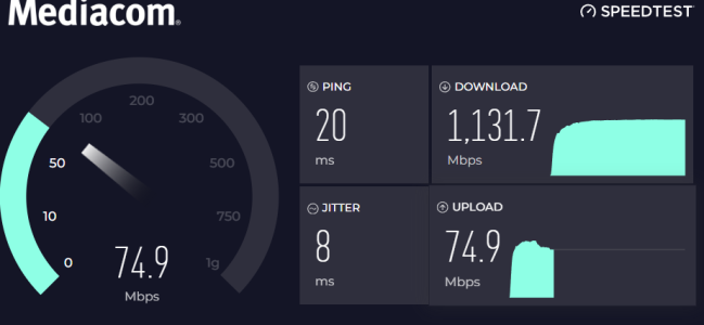

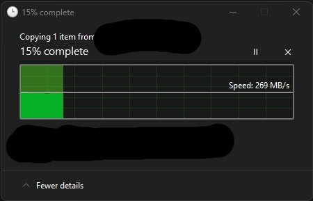

Yes it does work. Current modem provisioning is holding back but our rural system can get to 2.1G and 175M up in current state.
11 port with transceiver auto negotiated to 5G link speed of motherboard.

I am being limited by my modem provisioning, which is 1.2g d and 60M up. It only does that initial burst up sometimes past 100 but always settles at 60-65m ul.

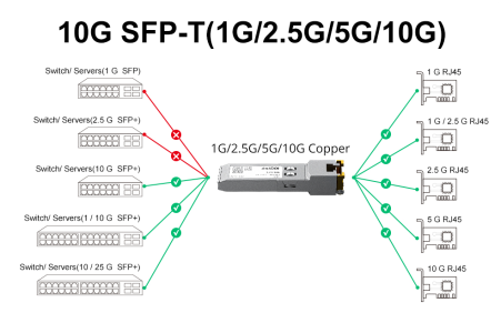

UI SPF to RJ45 would not do this. The right side of diagram. They are only 10 or 1.

The SFP+ to Rj45 claims 10 / 5 / 2.5 / 1
SFP to RJ45 is just 1Gb

Not too worried about everyone else's stuff. Just my PC, it has a 5G ethernet, and it says it's linked at 5g to DMP port 11 spf. Modem is 2.5G linked to DMP port 10 at 2.5G
So my PC will pull almost 1.2G down, limited by modem provisioning of 1.2G and 60M up.
My signal meter is provisioned for 2.4G down and 1.4G up and I can hit the 2G down, but our OFDMA is limited to about 175M upload due to 40/42mHz diplexers in the actives in the system. Meter can sustain about 125M up. depending on conditions since my port I am on is a 4 node port.
I swear I seen another employees modem provisioned for 144 upload. but still only the 1.2G down. Trying to figure how to get my modem upload reprovisioned higher. Corpo BS. They do offer a 100 upload in some areas. and 1G symmetrical in probably quad cities area.
