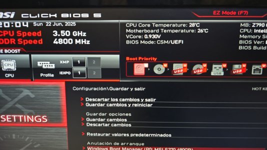

After assembling the system and powering it on, I immediately noticed the CPU temperature jumps to 100°C, even though the heatsink and the CPU surface don't feel that hot to the touch.
Initially, I noticed that the CPU fan header was incorrectly connected, and the UEFI showed 0 RPM for the CPU fan. I corrected this, and now the fan is spinning properly. However, the temperature still starts around 50°C and quickly rises to 100°C.
I also noticed the case fans are spinning(3), is Ok the temperature. They are connected to a built-in hub via 6-pin connectors, and the system reports 0 RPM for system fans as well.
Things I’ve tried so far:
  • Reseated the cooler
  • Reapplied thermal paste
  • Updated the BIOS to the latest version
Still no improvement.
Could this be a sensor misreading, a cooler mounting pressure issue, or something else related to BIOS configuration? Any suggestions to properly identify the root cause would be greatly appreciated.
Thanks in advance!

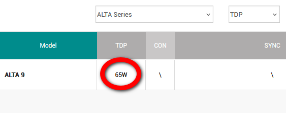

Worse than we thought. That is a 65W rated cooler. From DeepCool's website product TDP matrix:
Upgrade to an adequate CPU cooler, and not one with plastic push pins but screws to a backplate.

If the CPU reaches 100C while in BIOS, then clearly something is preventing the cooler from transferring heat. Yes, the cooler is very underpowered for this CPU, but it should still be able to prevent the CPU from reaching Tj Max under low load, especially while in the UEFI. Look at the image the OP has posted, the CPU is @100C while VCore is just under 0.8V, that CPU is using very little power and still cooking itself.

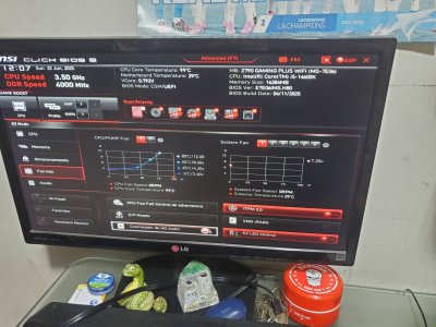

Thanks everyone for you time
Yes, the problem was the cooler CPU, I bought the "Hyper 212 Spectrum v3" and the temperature improved much.

Do you mean the 24hr format? Most people like it that way in the UK in my experience.
No, the updated photo also says june 22, 2025 like the one from the OP instead of perhaps a later date, so I guess the cooler was replaced ~8 hours after the OP.
No, the updated photo also says june 22, 2025 like the one from the OP instead of perhaps a later date.
Yeah, I thought that was a little odd, especially given that they posted a day after the second picture was apparently taken while still talking about the original problem in present tense.
