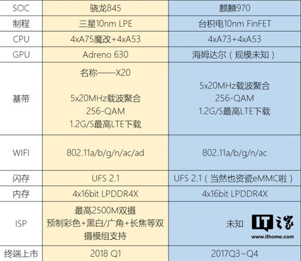

Seems that Kirin 970 and Snapdragon 845 are getting some leaks...
About the Kirin 970 was expected since it was ready for the Mate 10, the surprise is that is debuting a new GPU which is called Heimdallr MP... pretty weird.
On the other side the Snapdragon 845 is leaving for real the Custom/SemiCustom Cores (RIP Kryo) and using stock ARM A75 cores... wondering if this cores will not be the same dissaster like the A57.
Also new GPU finally... seems that the 600 series will delive some changes...
So this leaves Mediatek and Xiaomi evaluating the GPU to use... for Mediatek it could be PowerVR Furian since they (Imagination) will sell their GPUs on a pretty cheap price due Apple recent moves (no more PowerVR) and since Mediatek is a regular client of them... it could be interesting how them performs. Similar thing to Xiaomi. Mali is not as great as expecting for them.
Source: https://www.gizmochina.com/2017/05/19/kirin-970-snapdragon-845-details-launch-dates-leaked/

That leak looks super fake.
About the SD 845 it could be super fake... But the Huawei 970 was hinted to be at 10 nm and still using ARM A73 CPU... Using a new gen GPU seems logic too since G71 is already old.
