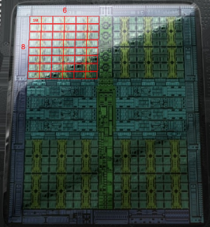

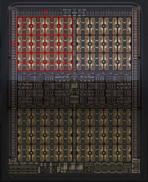

Good catch. Yeah, it looks like in terms of rows*columns at each quadrant, Blackwell was 8x6 while Rubin is 6x8. Same number of SMs, just a different aspect ratio.
Blackwell:
Rubin:
Blackwell:
Rubin:
Interestingly, on these Die shot visualizations Rubin CPX looks more like a gaming GPU instead of a datacenter GPU. Very close to AD102 and GB202. And in the press release they said availability by end of 2026, which would also align with the next gaming card release cycle.
So my questions would be:
  • Could it really be, that Nvidia massively increases tensor core capabilities in GR102 and re-uses it in datacenter?
    • Would also make sense for PCIe based accelerator cards and RTX Pro
  • Does this include only FP4 inferencing or all tensor core data formats?
  • Does this also apply for the smaller gaming GPUs in the Rubin line-up?
Good news for us is, that 32 Gbit GDDR7 modules are available by end of 2026. So manufacturers can choose between 16 / 24 / 32 Gbit modules and therefore, no cards with subpar VRAM capacities anymore.
