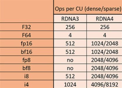

man...... if only AMD had a 96CU // 384bit part 🙁 ... my 7900XTX is 6 months olds , i'll still probably buy a 9090XTX. But right now its like RDNA 4 can do lower precision better , but has less memory (24gb vs 16gb matters for local LLM's ) and doesn't perform any better until FSR4 makes XESS on RDNA3 look like crap.
the distilled DS models would love RDNA4 , RDNA3 // 7900XTX was already at 4090 levels of performance in it.
