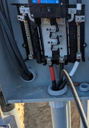

I get up there a day or two a week, with a 4 hour round trip commute. I have pulled in about 1400' of 12/2 NM-B, the 6/3 for the range and a few 10/3 for the dryer and the shop 240V outlets.
Yesterday I punched all the holes in the gutter, put up the critical loads panel and started the conduit for the inverter over on the right. I will cut that down about 8".
The breakers are coming in Monday and we can start laying stuff down.

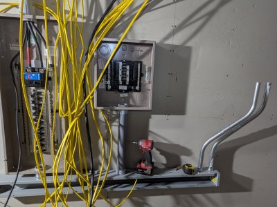

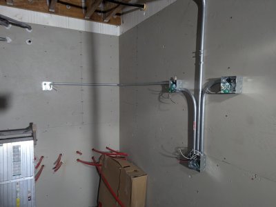

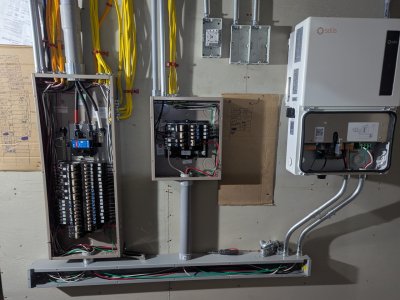

Inverter is up and powered in and out on the AC side. The rest is on a separate permit so I will work on that next weeks.
All the wire is terminated but a couple of conduit pulls to do tomorrow.
Everything for equipment is surface run in EMT
outlets out the basement door for a compressor outside and what-have-you.
Are you doing anything to monitor your circuit loads? I use a emporia energy monitor which gives me data on what is using power. Are you going to be doing a battery installation with the solar inverter? I did see you have a critical load panel.

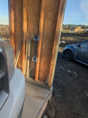

It's odd seeing Romex exposed on walls. Where I worked the rule was no exposed Romex below 8'. Attic and crawl space exempted.
It will get covered by some framing and plywood just as needed, and the room gets a hard sheetrock lid at 88.5"
Picture a few ripped 2x4 on the wall making a box around the romex, with plywood screwed to that.

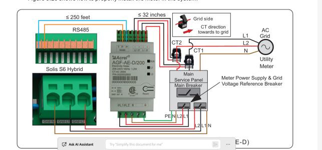

I'm not going to bother with circuit by circuit monitoring. The inverter came with this integrated monitoring system.
I am still figuring on where to put it. I think in the first panel outside because it has room to just sit that box inside with those short 32" leads, and then drop the RS485 on some CatX coming in with the RSD signal wire. It can sit in the corner here. Early picture, this is all built out with a 50 Amp GFCI and a 20 that goes to the nearby carport wall, and the 20KA plug on surge protector. There is one in each of those two outdoor panels. Some purists say you need 50KA and It does make me grin. How about the vast majority that have none? I also do not have an overhead line in sight, nor do we get enough lightning to enjoy, let alone worry about.
because of the split service I will not capture all the power usage once the shop is built. No worries.
I have an LG 16H 16KWH high voltage battery to go with that high voltage inverter.

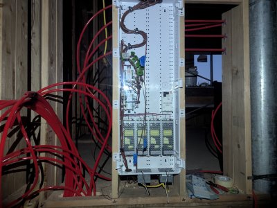

My house has hydronic heat and will be using a ground source inverter heat pump. I will also get a hybrid heat pump water heater.

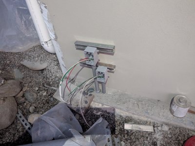

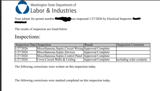

That all got inspected today and we pulled wire to the solar panels through EMT conduit.
I was quite worried about the inspection but it went very smoothly. I got to go over the solar stuff ahead of that inspection, a freebie and I pre-answered all his concerns there.

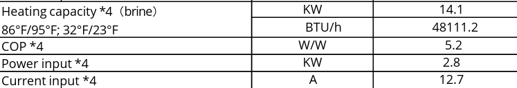

I just recently got Home Assistant installed on a PI box and I am exploring what I can do with that as far as aggregating all my smart home stuff together.
Personally I have found with solar that if you get a small bill, you use energy more.
In 2024-2025 True Up - I used 41 MWh of power for my house, pulled 14.8 MWh from the grid, Exported 6 MWh to the grid and produced 35 MWh of solar from 20kw of panels (DC) with 75 KWh of LFP batteries. This netted me out at the end of the true-up period (12 months) a total bill of about $300 from SDGE which made me fairly happy.
I also have 2 BEV's, a pool(In the process of getting rid off), spa and the house is fully electric. The only time we use Propane is for emergency heating with the heat pumps which is often in San Diego.
My best guesstimate of heat load at the 23F heating degree day is about 2KW continuous load.
I have the LG 16KWh battery, and can add a second.
14.76 Kw of panels x 4.5 hours at best is 66KWh on a good winter day. Theoretically, I could keep up in a power outage, and the 32KWh storage would be a decent matchup.
We do not have any lengthy outages though. Just spitballing it for fun.

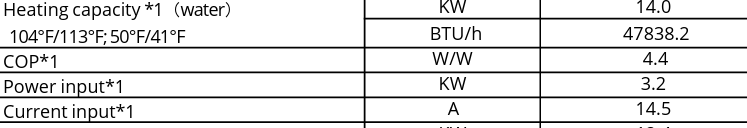

I had a big long post about the inverter heat pump and charts and deleted the tab, argh.
