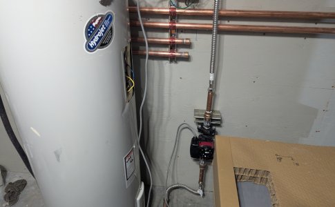

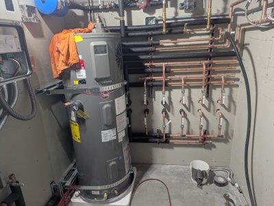

I got a heat pump water heater a few years back. Very expensive but figure it will save me in the long run. Curious though, is that tank heating the water for the hydronic system? Just wondering how that works from a thermal dynamics standpoint as I would figure it will just be moving heat from basement to upstairs but not changing the overall average temp of the house itself.

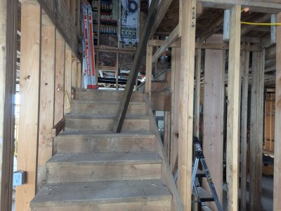

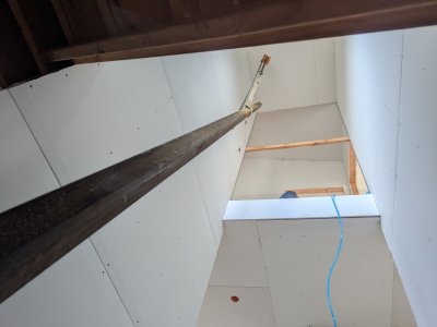

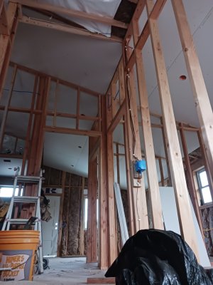

I brought the 24' long 290 pound lift column today, the last long load to the house. I unloaded it and it is waiting on the board cart for the sheet rock crew to finish the shaft down to the first floor deck.
I had embedded a 4x6 with a piece of 1/2" threaded rod in it for hoisting the column.
I put the eye on there and hiked that chain fall up a ladder and in place.
Then I demoed the 2nd floor safety deck.
This opened up a view I had only imagined on paper.

Rolled in, tipped and stabbed through the basement wall. It slid in on the edge of the safety deck and nobody had to drop a huevo to do it.
Rig it and hoist to this position.
Then we wrecked out that deck.
Up, over and down to the elevator pit.
We put the base bracket on the column, then rotated it and leaned it into the 2nd floor landing so we could mount the 80 pound motor unit. Chain fall FTMFW!
I could reach those lag bolts from the landing, and I got the other side from a ladder in the stairway.
First, note the basement has been sheetrocked. That happened over the last 3 days.
Chain fall is down and the bolt in the ceiling removed.

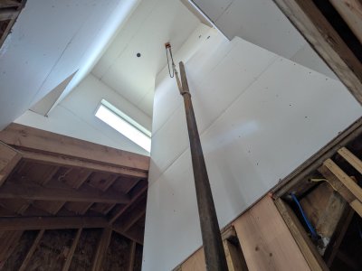

I set up a plumb bob from the 2nd floor down. That side of the shaft and the landings are spot on, not even a 1/16" across them.
I lined the column up with the plumb line, and noticed a slight variance in the 6' level bubble. Not much, just a fuzz.
So I went looking with the plumb line, and there is a 1/16" bow in the column. It is negligible but I found it.
I got the platform fitted and safety cable.

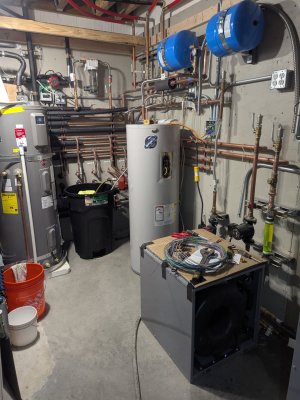

for those of you who like sciencing, the 4500 watt element in the water heater is 1.26 tons equivalent at the most. It was warm today and it got all the wood floor surfaces to ~70 degrees.

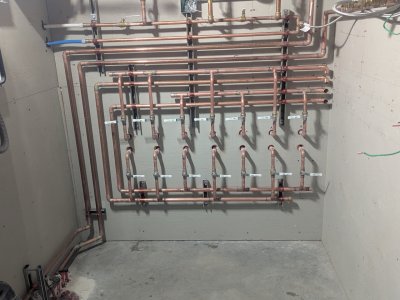

Then I hooked up the basement loops and purged the air one at a time. 6 1/2" loops @240' average.
They purged at ~1 GPM and I added make up water as I went, keeping the system pressure @20 PSI or so.
I surveyed the basement slab at ~55 degrees and now I am sending all the heat at it. It is running between 2 and 2.5 GPM across the 6.
I suspect it will take all weekend to get the slab to 65 degrees.
The PV system made 69KWH a day yesterday and today. We are still running in deficit with heating the house for two mud crews drying out drywall mud, but with any luck we will have the first Ground Source Heat Pump (GSHP) operating by the end of the week.
All the heating has been done at a COP of 1 with resistive heating.
We can kick that shizzle to the curb and start doing ~3.5 COP heating. That is a game changer,

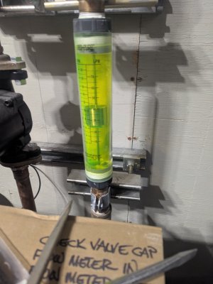

We charged the ground loops with 65 gallons of glycol and 10 of water. I rigged up the circulation pump and it flowed 10+ GPM with all 7 loops, and 8+ with the 4-pack.

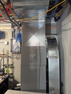

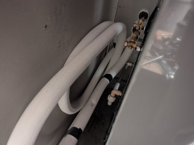

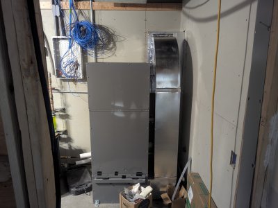

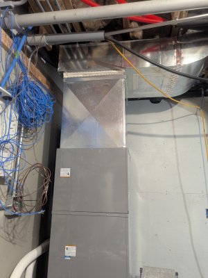

Stacked up the HVAC components, installed the return air duct and the lineset.

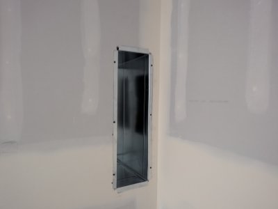

Free return duct flanged to the wall outside.

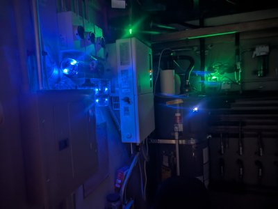

obligatory purty lights in the dark.
Aren't the expansion tanks supposed to be installed with the fluid connection on top so you don't end up with an air bubble in them? Or does that not really matter?
I had designed, assembled and installed all the ducting up to that point. The local contractor sent out a tech to measure this transition, go back and build it in the shop, and come back and install it.PXL_20260401_185120554.jpg
I will wire it all up and commission the unit tomorrow and unhook that resistive heating power hog upstairs.
today was a banner day. I had tried to commission the heat pump yesterday and ran afoul of an error that prevented the start up. I emailed tech support and he had me switch one of the Dip switches to a different setting ( NOT what was laid out in the manual) and that fixed it.
We are harvesting heat from the earth and electricity from the sun 🙂

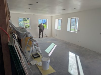

The upstairs mud crew is sanding now, and the basement crew is about done. We plan on painting at noon tomorrow and blast out the basement. Then we can install lights, switches, and outlets down here and get the cabinet shop going.
