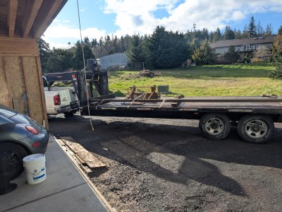

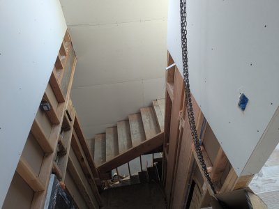

I brought the 24' long 290 pound lift column today, the last long load to the house. I unloaded it and it is waiting on the board cart for the sheet rock crew to finish the shaft down to the first floor deck.

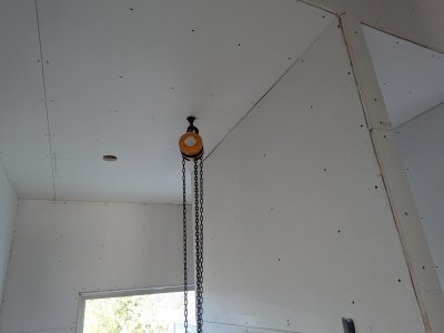

I had embedded a 4x6 with a piece of 1/2" threaded rod in it for hoisting the column.
I put the eye on there and hiked that chain fall up a ladder and in place.

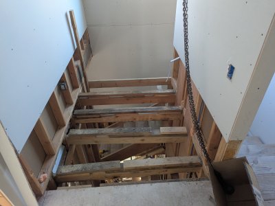

Then I demoed the 2nd floor safety deck.

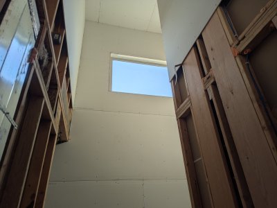

This opened up a view I had only imagined on paper.
Picture climbing plants on the right wall.

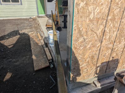

Rolled in, tipped and stabbed through the basement wall. It slid in on the edge of the safety deck and nobody had to drop a huevo to do it.
Rig it and hoist to this position.
Then we wrecked out that deck.
Up, over and down to the elevator pit.

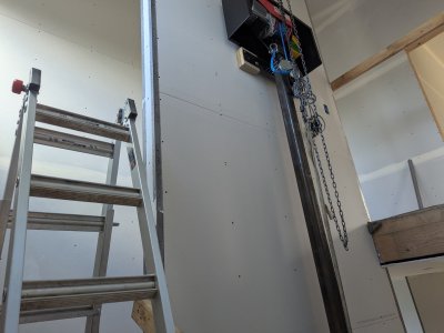

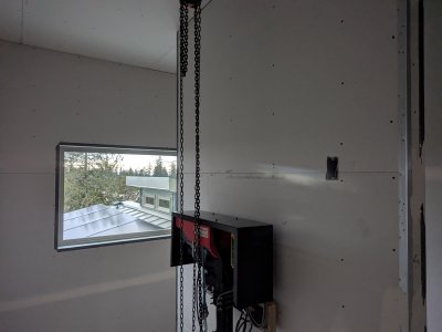

We put the base bracket on the column, then rotated it and leaned it into the 2nd floor landing so we could mount the 80 pound motor unit. Chain fall FTMFW!
I could reach those lag bolts from the landing, and I got the other side from a ladder in the stairway.
First, note the basement has been sheetrocked. That happened over the last 3 days.
Chain fall is down and the bolt in the ceiling removed.
I set up a plumb bob from the 2nd floor down. That side of the shaft and the landings are spot on, not even a 1/16" across them.
I lined the column up with the plumb line, and noticed a slight variance in the 6' level bubble. Not much, just a fuzz.
So I went looking with the plumb line, and there is a 1/16" bow in the column. It is negligible but I found it.

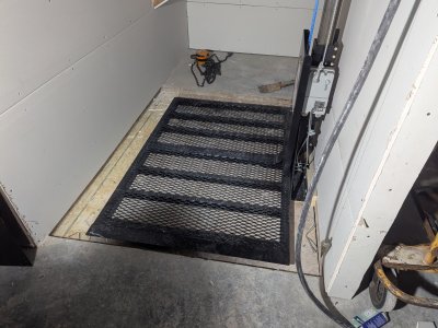

I got the platform fitted and safety cable.

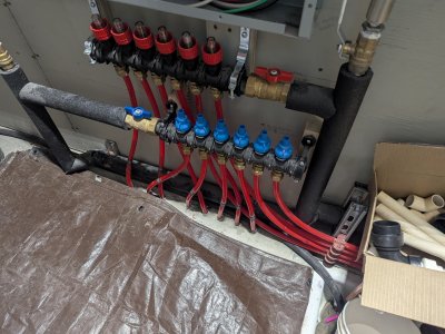

Then I hooked up the basement loops and purged the air one at a time. 6 1/2" loops @240' average.
They purged at ~1 GPM and I added make up water as I went, keeping the system pressure @20 PSI or so.
I surveyed the basement slab at ~55 degrees and now I am sending all the heat at it. It is running between 2 and 2.5 GPM across the 6.
I suspect it will take all weekend to get the slab to 65 degrees.
